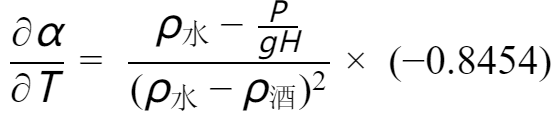

采用线性拟合,得到酒精密度
与温度T(℃)之间的关系为:
根据公式(4)得到:
在温度为25℃时,为了达到0.5%的测量精度,
温度的测量误差<span class="syl-plugin-formula" data-content="{"url":"https://p3.toutiaoimg.com/origin/tos-cn-i-qvj2lq49k0/7509a1adf29442b8a67fc0310a031fdb","uri":"","width":496,"height":28,"darkImgUrl":"https://p3.toutiaoimg.com/origin/tos-cn-i-qvj2lq49k0/6f9f66d475e4497fa37ca9613d577707","darkImgUri":"","formulaImgStatus":"succeed"}" data-formula="\Delta T
