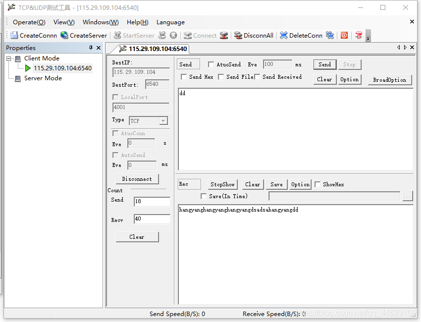

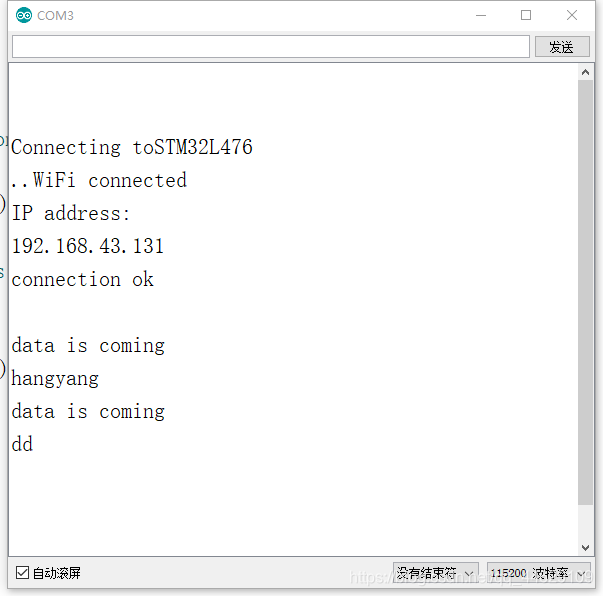

实验要求
通过将ESPDuino开发板设置成TCP Client模式,从而达到联网通信
具体方法
登录http://tcp.doit.am获取要使用的IP和端口:
<font _mstmutation="1"><font _mstmutation="1"><font _mstmutation="1">#include<ESP8266WiFi.h>const char*ssid ="STM32L476"; const char*password ="284122348"; const char*serverIP ="115.29.109.104"; int serverPort =6558; WiFiClient client; bool bConnected =false; char buff[512]; int nm =0; void setup(){ Serial.begin(115200); delay(10); Serial.println(); Serial.println(); Serial.print("Connecting to"); Serial.println(ssid); WiFi.begin(ssid,password); while(WiFi.status()!=WL_CONNECTED){ delay(500); Serial.print("."); } Serial.println("WiFi connected"); Serial.println("IP address:"); Serial.println(WiFi.localIP()); } void loop(){ delay(1); if(bConnected ==false) { if(!client.connect(serverIP,serverPort)) { Serial.println("connection failed"); delay(5000); return; } bConnected=true; Serial.println("connection ok"); } else if(client.available()) { Serial.println("data is coming"); while(client.available()) { buff[nm++]=client.read(); if(nm>=511)break; } buff[nm]=0x00; nm=0; Serial.print(buff); client.print(buff); client.flush();</font></font></font> } }
